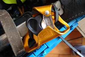

I had an awesome elm removal today to try it out on today. It worked flawlessly. To be honest, I couldn't believe how much more comfortable and smooth it was in comparison to wearing my CT foot ascender, either over or under my spurs. No lie, it felt much better.

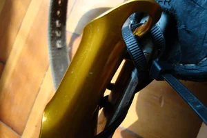

Now i'm not saying its going to work, or its a work safety thing...but I just wanted to try a method that could be throw away if needed, and something that takes two seconds to do...its a wide cabletie wrapped in a figure 8 on a croll, the position is good and it only moves a bit with my full weight on it.
Should be giving it a try in a few days.
