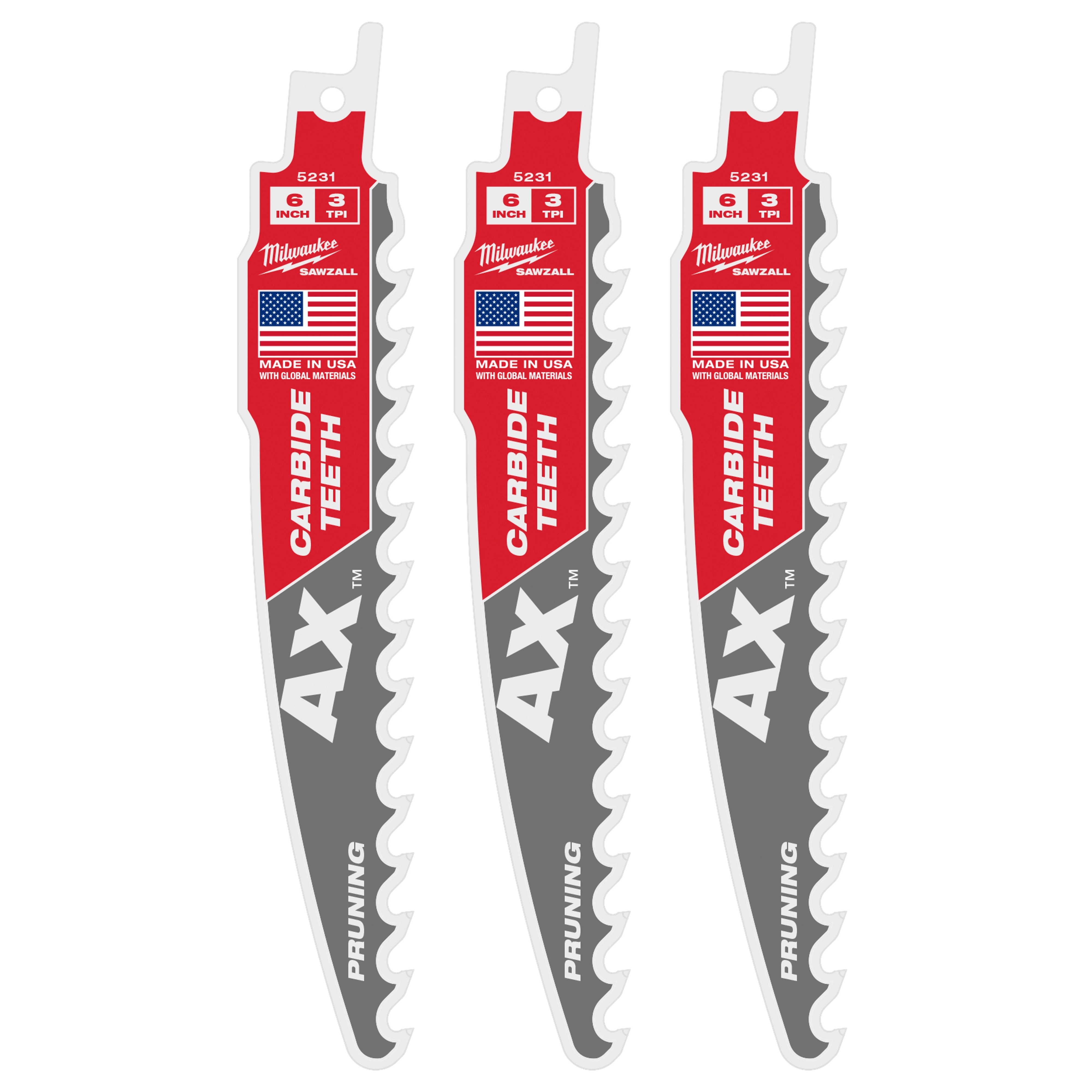

OK...the mini-saw is suspect...this looks legit
I've got a long, coarse, straight blade for my cordless recip saw. Its come in handy for a few specific cuts that would have been dicey with a chainsaw.
Now I see this curved, Japanese-style blade/ in a three pac that aims to replace my trusty Silky product.
Who else is using a battery reciprocating saw for tree work
Good find. If my sawsall weren't far more cumbersome than a battery Echo I would get some now to try.
I’ve looked into pruning blades for recip saws, thinking of more disposable options for root pruning. Haven’t come around to ever experimenting with them though.
If you want blades for a root pruning, look into the really aggressive carbide tipped blades. The pruning blades won't last very long, those carbide tipped blades should.
I might try one of those...but you are right: the others don't last long. I get the 12" blades. They are about $2 each. I use bolt cutters to cut them in half when the front gets dull. Doesn't hurt too bad to throw away $2 blade that has served its purpose. At $5 each...if it saves time, well worth it. But I'm cheap enough I'd try to hold on to those longer LOL
Bi-metal blades are more durable in grit than nice big coarse toothed wood blades, finer teeth but they still cut a root with persistence.
Never wield a chainsaw in anger against a root, no matter how pooched the chain and bar, it will only bring more sorrow.
