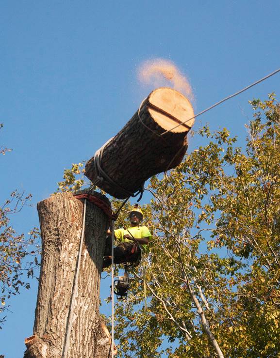

Even the large red oak logs pictured in this article were lowered smoothly and decelerated to a stop about 6 feet from the ground. The redirects and rigging points were all X-Rigging Rings.
 pic6
Photo courtesy of Arbor-X Inc.
My ride was very calm and stress free.  On the largest logs, two 1 inch diameter rigging lines were used.  One rigging line ran from a Hobbs device, the other from the aluminum bollard on the GRCS(Good Rigging Control System), through a set of extra-large X-Rigging Rings (nicknamed the “beast rings”) -that pulled the lines away from the log slap zone on the trunk.  The terminal rigging points were two more sets of the extra-large “beast” rings in a double ring configuration.
