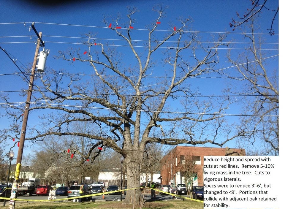

Regenerative pruning is a form of directional pruning. It follows acceptable standards when the objective is established, the requirements are met, and specifications are communicated in a way that both workers and clients understand. For example, if the objective is “Post oak 6-feet wide at base, 5-feet hollow, root damage: Increase health and value over time, lower cost, risk, and load,” specifications could fit on a pocket-sized card:
  1. Remove outer dead branches greater than 1-inch diameter
  2. Reduce sprawling leaders. Cuts less than 3 inches to uprights, less than 8 per cent total foliage
  3. Reduce downward and horizontal branches. Clear growth below by 2-4 feet. Less than 4 per cent total
  4. Thin crowded branches. Less than 2-inch cuts, less than 3 per cent total
  5. Smallest cut possible, near vigorous growth or buds
  6. Start 3 feet from the trunk to 20 feet: make holes greater than 2 inches wide, 18 inches apart, greater than 12 inches deep. Force 50 per cent expanded aggregate and 50 per cent specified soil conditioner under pressure into the holes. Irrigate. Mulch 2-inch woodchips

Over 90% hollow at the base, this tree was slated for removal after an incomplete and defective assessment.  One climber in 5 hours gave it a pruning that will last.
