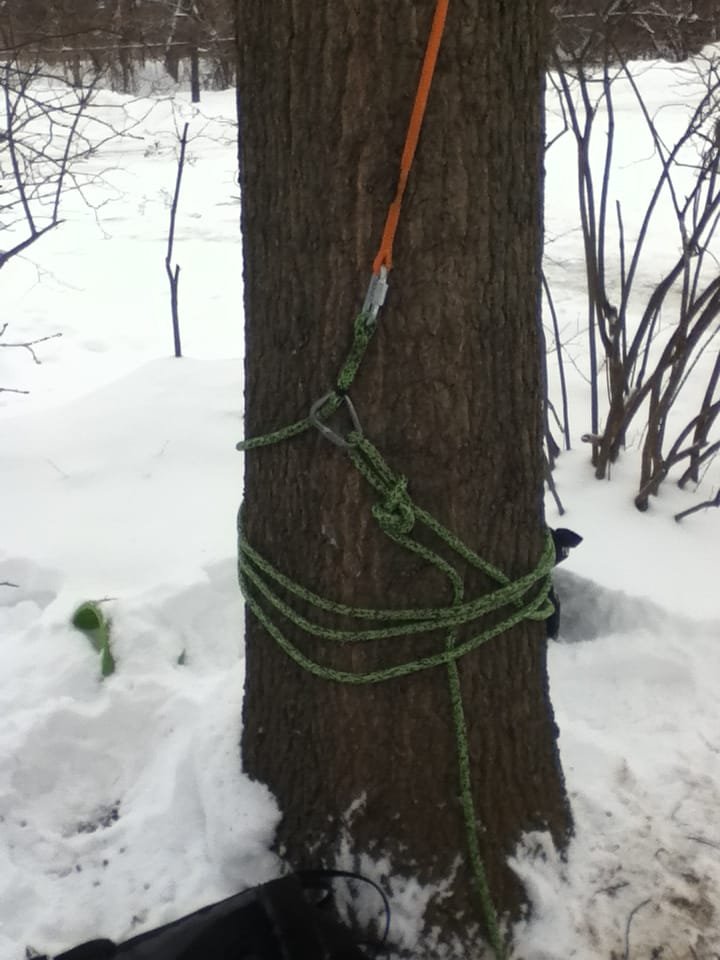

The anchor I now use most frequently is another that has been adopted and adapted to fit my needs and the gear that I had on hand. It is formed by taking multiple wraps around the anchor point with the climb line, then passing a bight up between the wraps and the trunk, tying a midline knot, and attaching it to the anchor leg of the line with a steel quick link. The wraps tighten on the bight which tends to hang loose from the quick link, enabling a rescuer to get the quick link opened and disengaged with relative ease. The knot is then untied, the bight is pulled out from under the wraps and the climber can be lowered. This system, while technically not fail safe can be made virtually so through the addition of wraps on the trunk.mac1

In the trunk wrap system the two ropes can be connected below the wraps on the tail of the bight. Or above the wraps, as in this picture, just past the delta link, again to maximize possible distances for lowering, and give the climber plenty of working end.
mac2
