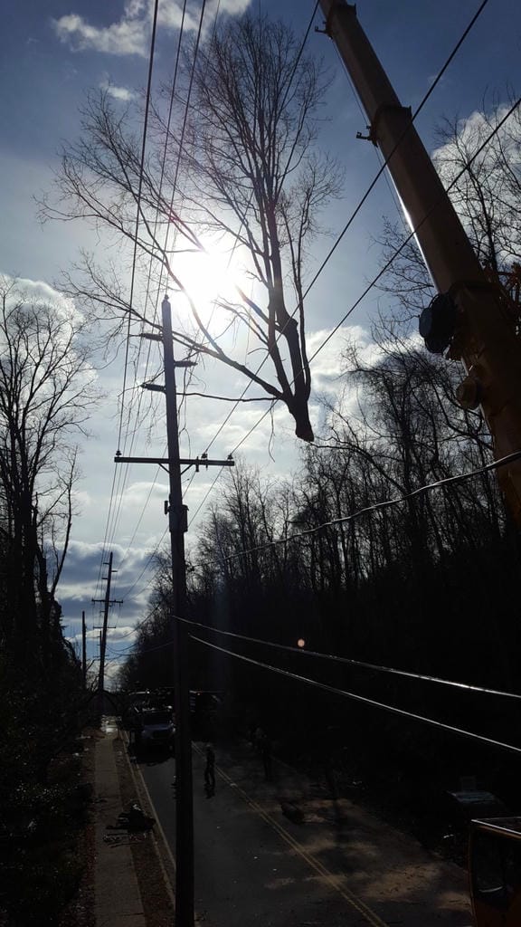

Sometimes you have a great tree and you feel pretty safe climbing it and you can rig it, but it may be problematic to get the brush down. It is over a roof, service drops, a playground or greenhouse. Bring a crane in and you can lift it up and put it down in a spot where you decide and manage things very comfortably.
